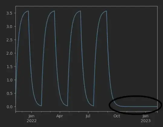

Before passing the data to the algeorithm for learning, I logarithmized the data, formed the firstdifference, and tried to clean up the difference in seasonality. When I create a prediction with SARAMIAX I get only one constant like here:

I have read in some examples that it is not an error of the Sarimax model, but since the prediction only refers to the previous value, only a constant can be predicted.
Now, of course, I'm wondering whether I'm on the wrong track with SARIMAX, or whether I've simply taught the model incorrectly and can continue to work with SARIMAX. Maybe there is another ML algorithm you would prefer for this task?

  • There are indeed a few people here with a little experience with time series forecasting (cough). First off, you should not need to logarithmize and take differences yourself, any self-respecting ARIMA tool should do that automatically. I suspect the issue is that you are not specifying the length of the periodicity. How long (in your underlying time granularity, i.e., hours) is a cycle in your application? – Stephan Kolassa Feb 12 '23 at 14:40

Here is a tutorial on pmdarima.auto_arima. If you have quarter-hour time buckets, and each cycle lasts 2000 hours, you would need to specify the parameter m=4*2000 and seasonal=True.
This will probably break your Python kernel, because ARIMA simply was not built for such long seasonal patterns. (In addition, I don't think this implementation can deal with external regressors, so you would need to run your own regression on any predictors, then run residuals through auto_arima.)
I very much recommend this blog post by Rob Hyndman on how to deal with long seasonalities. It's in R, not Python, but the forecasting functionalities in R are better, anyway. Since you seem to have external predictors (it's not completely clear to me from your question), you could put these into a design matrix, then add columns for the Fourier terms as per the blog post, and feed all of this into the xreg parameter of forecast::auto.arima().
