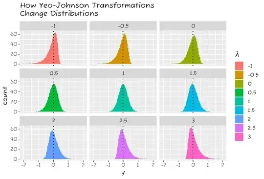

A table adds little, but a picture can add a lot more to our understanding. I offer two pictures.
Unlike the Box-Cox transformation, which applies to positive numbers, the Yeo-Johnson transformation applies to all numbers. It does so by splitting the real line at zero, shifting the positive values by $1$ and the negative values by $-1,$ and applying a Box-Cox transformation to the absolute values, negating them when the argument is negative. In effect, it sews two Box-Cox transformations together. However, they have "inverse" Box-Cox parameters. The natural origin of the Box-Cox parameters is $\lambda = 1$ and the "inverse" parameter is
$$\lambda^\prime = 2 - \lambda,$$
reflecting the parameter line around $\lambda = 1.$ The sewing is smooth (as you will see in the first plot below) because all Box-Cox transformations are by design made to agree with the identity transformation at $x = 1.$

The graphs of $\operatorname{YJ}$ show the effects on the data for various $\lambda,$
Here's what they do to a reference (Normal) distribution (the green distribution for $\lambda = 1$ in the middle panel):
Like the Box-Cox family, these transformations make a distribution more positively skewed when $\lambda \gt 1$ and more negatively skewed when $\lambda \lt 1.$
