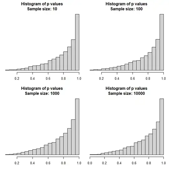

Edit: John Madden asks a very interesting question:
Wouldn't large sample sizes allow for hand-waving away the fact that parameters had to be estimated by standard arguments (i.e. continuous mapping theorem?), and perhaps this is where the idea that KS is more appropriate for large samples comes from?
Let's take a look. We will simulate $x_1, \dots, x_n\sim N(0,1)$, for increasing sample sizes $n$. For this vector $x$, we perform a Kolmogorov-Smirnov test against a normal distribution with mean and standard deviation equal to the mean and standard deviation of $x$, and store the $p$ value. For each $n$, we do this simulation exercise 10,000 times and plot the $p$ values in a histogram. If the K-S test were valid, this histogram would be uniform, and if John's question had a positive answer, the histograms would become more uniform as $n$ increases. So we run the exercise for $n\in\{10,100,1000,10000\}$. The histograms don't get any more uniform, so no, the K-S-test against estimated parameters does not get better for large sample sizes:
histograms
R code:
exponents <- 1:4
par(mfrow=c(2,2),mai=c(.5,.1,.5,.1))
for ( ee in exponents ) {
    p_values <- rep(NA,1e4)
    for ( ii in seq_along(p_values) ) {
        sims <- rnorm(10^ee)
        p_values[ii] <- ks.test(sims,pnorm,mean=mean(sims),sd=sd(sims))$p.value
    hist(p_values,xlab="",yaxt="n",
        main=paste("Histogram of p values\nSample size:",10^ee))
(It turns out that whuber already did this analysis almost a year ago.)
As various commenters point out completely correctly, there are different ways of addressing this property of the K-S test, like the Lilliefors modification, or bootstrapping the test statistic obtained with estimated parameters.

    Wouldn't large sample sizes allow for hand-waving away the fact that parameters had to be estimated by standard arguments (i.e. continuous mapping theorem?), and perhaps this is where the idea that KS is more appropriate for large samples comes from? So so long as we have consistent estimators, we can be comfortable using KS in large samples sizes? (ignoring the fact that normality tests are not typically very informative in large samples to begin with....). – John Madden Dec 12 '22 at 19:31
    @StephanKolassa: Yet when people bootstrap the distribution of the K-S statistic from a best-fit null they call that a "Kolmogorov-Smirnov test". Whatever position you take on the naming of tests, it's always a good idea to mention Lilliefors tests if you're saying the K-S test needs a prespecified distribution under the null. – Scortchi - Reinstate Monica Dec 12 '22 at 20:13
    @JohnMadden: that is a very interesting question, and the answer seems to be "no", take a look at my edit. – Stephan Kolassa Dec 13 '22 at 08:21
  • @StephanKolassa thank you for investigating this. – John Madden Dec 13 '22 at 16:46
    @John I posted the results of the same study a year ago at https://stats.stackexchange.com/a/564922/919 ;-). – whuber Dec 13 '22 at 21:07
    @whuber: and it turns out I had already upvoted that earlier answer of yours, so I can't do it again, sorry... – Stephan Kolassa Dec 14 '22 at 07:07
