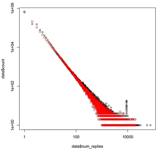

If I then use this Zipfian model (alpha = 1.703164) along with a random number generator to generate the same total number of topics (1400930) as the original measured dataset contained (using this C code I found on the web), the result looks like:
Random number generated results
Measured points are in black, randomly generated ones according to the model are in red.
I think this shows that the simple variance created by randomly generating these 1400930 points is a good explanation for the shape of the original graph.
