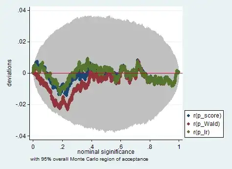

The standard approaches are the Wald test, the likelihood ratio test and the score test. Asymptotically they should be the same. In my experience the likelihood ratio tests tends to perform slightly better in simulations on finite samples, but the cases where this matters would be in very extreme (small sample) scenarios where I would take all of these tests as a rough approximation only. However, depending on your model (number of covariates, presence of interaction effects) and your data (multicolinearity, the marginal distribution of your dependent variable), the "wonderful kingdom of Asymptotia" can be well approximated by a surprisingly small number of observations.
Below is an example of such a simulation in Stata using the Wald, likelihood ratio and score test in a sample of only 150 observations. Even in such a small sample the three test produce fairly similar p-values and the sampling distribution of the p-values when the null hypothesis is true does seem to follow a uniform distribution as it should (or at least the deviations from the uniform distribution are no larger than one would expect due to the randomness inherrit in a Monte Carlo experiment).

simulate p_score=r(p_score) p_Wald=r(p_Wald) p_lr=r(p_lr), reps(2000) : sim
simpplot p*, overall reps(20000) scheme(s2color) ylab(,angle(horizontal))
