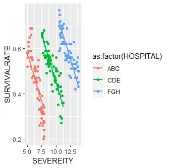

ggplot(data_hos,aes(x= SEVEREITY, y = SURVIVALRATE, color = as.factor(HOSPITAL)))+
  geom_point() +
  geom_line(aes(y = predlm), size = 1)
with the output fit as enter image description here
What is the difference between these two as they both seem to do the same thing. Even after reading many articles and posts online, I could never understand it entirely.
