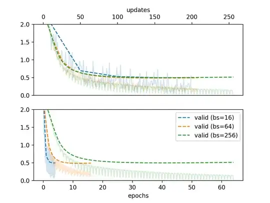

Wait a minute... Who said that more updates is better?
That turns out to depend on how you do the updates. If the gradient for a single sample, $(\boldsymbol{x}_i, \boldsymbol{y}_i),$ would be $$\nabla_\theta L(g(\boldsymbol{x}_i \mathbin{;} \theta), \boldsymbol{y}_i)$$ (with $\theta$ the set of parameters and $L$ some loss function), the gradient for the entire dataset should equal $$\sum_{i=1}^N \nabla_\theta L(g(\boldsymbol{x}_i \mathbin{;} \theta), \boldsymbol{y}_i).$$
If we use each sample exactly once in the on-line setting the $N$ updates should be roughly equivalent to the single update from the full-batch setting. Especially if the learning rate is small enough (i.e. the individual updates do not change the weights too much).
The figure below illustrates the learning curves when trained on the sum of errors. Note that performance does not depend on the number of updates (but it does depend on the number of passes through the data). plot depicting learning curves as functions of updates vs epochs when trained on sum of errors

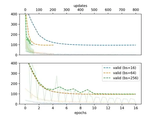

However, instead of optimising the sum of errors, it is actually more common to optimise the average error. This means that the update in the online setting remains the same, whereas the update for the full batch is reduced by a factor $N$:
$$\frac{1}{N} \sum_{i=1}^N \nabla_\theta L(g(\boldsymbol{x}_i \mathbin{;} \theta), \boldsymbol{y}_i).$$
In this case, the update in the full batch setting is much smaller (in the same scale as a single update in the online setting, if you want). This also means that more updates leads to better performance.
The figure below illustrates the learning curves when trained on the average error. Note that the performance depends on the number of updates (and not on the number of passes through the data).
plot depicting learning curves as functions of updates vs epochs when trained on average error
  • How the performance doesn't depend on the number of epochs? In the last figure, the blue curve reaches a lower value faster than the other ones. – ado sar May 09 '23 at 19:53
  • @adosar The average performance does not depend on the number of epochs. In the first figure, the validation errors (dashed lines) are corrected for the batch-size, whereas the training errors (full line) are plain sums over the batch-size. – Mr Tsjolder from codidact May 10 '23 at 07:52
