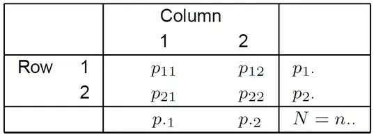

Here is the derivation using the delta method. Let's look at the familiar $2\times2$-Table below.
2x2 Table
Suppose that $\theta = f(p_{11},p_{12},p_{21},p_{22})$ where $p_{ij}$ is defined as in the table above.
The Odds Ratio is defined as $$ \theta=\mathrm{OR}=\dfrac{p_{11}p_{22}}{p_{21}p_{12}} $$ We want to derive the variance of $\theta$. The multivariable version of the delta method is: $$ \operatorname{Var}(\hat{\theta})\approx \nabla f(p_{11}, p_{12}, p_{21}, p_{22})\cdot \operatorname{Cov}(p_{11}, p_{12}, p_{21}, p_{22})\cdot \nabla f(p_{11}, p_{12}, p_{21}, p_{22})^{T} $$ Where $\nabla$ is the gradient vector. That is: $$ \nabla f(p_{11}, p_{12}, p_{21}, p_{22}) = \left(\frac{\partial f}{\partial\,p_{11}}, \ldots,\frac{\partial f}{\partial\,p_{22}}\right) $$ We want to estimate $$ \operatorname{Var}(\log(\mathrm{OR}))=\mathrm{Var}\left[\log\left(\frac{p_{11}p_{22}}{p_{21}p_{12}}\right)\right] $$ Let the function $f$ be $$ f = \left[\log(p_{11}) + \log(p_{22}) - \log(p_{21}) - \log(p_{21})\right] $$ The gradient $\nabla f$ is $$ \nabla f = \left(\frac{1}{p_{11}},-\frac{1}{p_{12}},-\frac{1}{p_{21}},\frac{1}{p_{22}}\right) $$ The variance covariance matrix for a multinomial distribution with $c=4$ categories is $$ \Sigma=\frac{1}{n}\left( \begin{array}{cccc} \left(1-p_{11}\right) p_{11} & -p_{11} p_{12} & -p_{11} p_{21} & -p_{11} p_{22} \\ -p_{11} p_{12} & \left(1-p_{12}\right) p_{12} & -p_{12} p_{21} & -p_{12} p_{22} \\ -p_{11} p_{21} & -p_{12} p_{21} & \left(1-p_{21}\right) p_{21} & -p_{21} p_{22} \\ -p_{11} p_{22} & -p_{12} p_{22} & -p_{21} p_{22} & \left(1-p_{22}\right) p_{22} \\ \end{array} \right) $$ Then $\nabla f\,\Sigma$ equals $$ \nabla f\,\Sigma=\frac{1}{n}\times \left[1, -1, -1, 1\right] $$ Now we need $(\nabla f\,\Sigma)\times \nabla f^{T}$ which equals: $$ (\nabla f\,\Sigma)\times \nabla f^{T}=\frac{1}{n}\times \left[\frac{1}{p_{11}} +\frac{1}{p_{12}}+\frac{1}{p_{21}}+\frac{1}{p_{22}}\right] $$ Substituting the MLEs for $\widehat{p_{ij}}=n_{ij}/n$ finally yields $$ \widehat{\operatorname{Var}(\log(\operatorname{OR})}=\frac{1}{n_{11}}+\frac{1}{n_{12}}+\frac{1}{n_{21}}+\frac{1}{n_{22}} $$ So the approximative standard error for the relative risk on the log-scale is $$ \widehat{\operatorname{SE}(\log(\operatorname{OR})}=\sqrt{\widehat{\operatorname{Var}(\log(\operatorname{OR})}}=\sqrt{\frac{1}{n_{11}}+\frac{1}{n_{12}}+\frac{1}{n_{21}}+\frac{1}{n_{22}}} $$ So an approximative two-sided confidence interval of level $\alpha$ for the relative risk on the original scale is $$ \mathrm{CI}=\exp(\log(\operatorname{OR})\pm z_{1-\alpha/2}\times \operatorname{SE}(\log(\operatorname{OR})) $$

  • @ CoolSerdash: This is a really cool answer and I want to spend some time trying to understand it! – stats_noob Sep 11 '22 at 19:21
  • When you wrote "We want to derive the variance of θ. The multivariable version of the delta method is" .... can you please explain how you were able to use the Delta Method to figure out that Variance(thetha) = Del(p11, p12, p13, p14) * cov(p11, p12, p13, p14) * Del-Transpose(p11, p12, p13, p14)? – stats_noob Sep 11 '22 at 19:23
  • @MBA_Grad_Student_2022 Thanks. I'm not sure what you're asking. The multivariate delta method is derived on Wikipedia, for example. Then it's just a matter of calculating the "ingredients" of the delta method. – COOLSerdash Sep 11 '22 at 20:02
