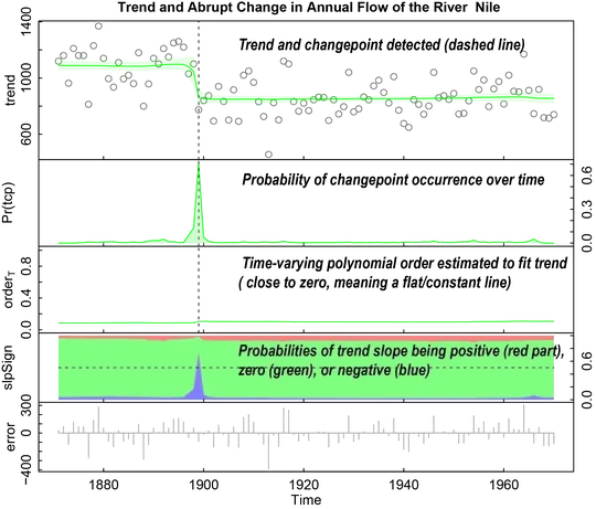

Allow me to use one package Rbeast written by me and available in R and Matlab ( more info at https://github.com/zhaokg/Rbeast) to illustrate the basic idea. It accepts regular or irregular data with or without a periodic component. It seeks to decompose a time series into trend and seasonality and simultaneously detect changepoints in the trend and seasonal components.
library(Rbeast)
Nile: an annual riverflow time series of the River Nile
season='none': no periodic/seasonal component so no time series decomposition is performed and only changepoint detection is done
o = beast(Nile, season='none')
plot(o)
The time series is divided into two segments, with one changepoint. The time-varying probability of changepoint occurrence in the trend component is shown in the second subplot Pr(tcp). The sgnSlp subplot gives the probability of the slope being positive, zero, or negative over time.
