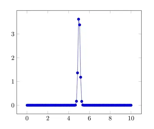

We can verify if the function we're working with is linear or non-linear with respect to $N$ by plotting the function:
using CairoMakie
xs = 0:0.01:600 ys = @. xs / ((xs - 1) * (se)^2 / (p * (1-p)) + 1) lines(xs, ys; axis=(; xlabel=L"N", ylabel=L"n"))
nonlinear
The above plot shows us this function is non-linear with respect to $N$ and is approaching $100$ as $N \to \infty$. Since it's non-linear we should make use of simulations to better understand $n$ given $\hat N$:
using MonteCarloMeasurements
N_est = 100 ± 25 # Construct Gaussian uncertain parameter n_est = N_est / ((N_est - 1) * (se)^2 / (p * (1-p)) + 1) n_est
## Particles{Float64, 2000}
##  49.4265 ± 6.69
The result from above could be a bit misleading since it gives you back a $\pm$ but this does not mean the result is symmetric so it's good to plot the raw samples to have a better idea of what's going on:
samp_quant = pquantile(n_est, [0.025, 0.5, 0.975])
hist(Array(n_est), bins = 50, axis = (;xlabel=L"n", title = "Samples of estimated sample size after population uncertainty propagation"))
vlines!(samp_quant, color = :black, linestyle = :dash)
current_figure()
samples
So via simulation we have a distribution for $n$ and we can now see this distribution is a bit skewed.
If we wouldn't have taken into account the uncertainty of $\hat N$ then we would have chosen $n \approx 50$ (note that's our median as well) but given that we can do uncertainty propagation we may want to choose a more conservative choice of $n \approx 60$.
