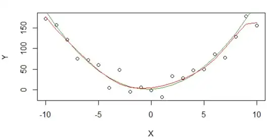

I was able to add regressors up to $X^7$, here is what it looks like: enter image description here
You can see that there is a first sign of overfitting at the last data point: the regression overfits and make the predicition very close to the actual point whereas it should not be that close: we observe a deviation between the green line and the red line, due to overfitting, which corresponds to a worsening of the out-of-sample prediction accuracy in that area.

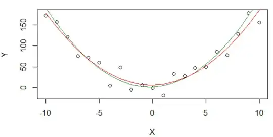

I changed my data (but kept the general concepts: quadratic true model vs high order polynonial (15)). Here is the result:
You can see that using many predictors allowed the model to create a prediction curve which comes extremely close to all the observations. But this accuracy is only artificial, it creates deviations from the true model. This is an example of overfitting.
