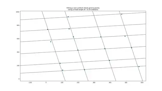

I have a list of coordinates that are meant to form an orthogonal grid that could be rotated. The grid is not necessarily uniform. The rotation is not typically greater than 10°. The coordinates are noisy and some are missing. I want to fit an orthogonal grid to the coordinates and return a list of the grid's vertices.
I have an algorithm that I wrote in Python that was able to find the grid in the image above and many like it, but was hoping to find a more robust algorithm in Python or R.
Current algorithm
  1. Find a reference gridline to compare with the remaining points by choosing two neighboring points in the first or last row with a slope closest to zero.
  2. Calculate the distances between this reference line and the remaining points.
  3. Segment points into groups w.r.t. the calculated distances based on group range. Each group should represent one gridline.
  4. Repeat steps 1 to 3 for the 90° rotated set of the same points. Combine results.
  5. Create a parallel slopes OLS model to determine linear equations for the gridlines.
  6. Rotate back the gridlines for the previously rotated points to their original orientation.
  7. Calculate the intersection points.
I used NumPy for the data, KDTree from SciPy for segmenting, and ols statsmodels.formula.api for the parallel slopes model.

I was hoping to keep the question more general because I find it to be a interesting statistics problem. Keeping it general keeps the assumptions to a minimum. For example, my first solution assumed the grid would be uniformed and aligned with the axes of the coordinate system in a Euclidean plane (i.e. not rotated). I was wrong, so my solution failed in many cases. A more detailed question could also introduce biases and lead to going off on tangents (e.g. data collection).
That said, this algorithm is meant to determine a grid of objects in a digital image (no gridlines, just objects). The data points come from the results of contour or edge detection using OpenCV. Examples include an image with a grid of headshots, a street grid, a lattice in a SEM image, etc. The points are noisy or missing because different shadings can have significant effects on contour detection. Another example is using face detection in locating headshots. The headshot photos (rectangles) might line up on a grid, but the faces are not aligned or not detected.
The images typically don't contain more than 200 points, rotated more than 10 degrees, or missing more than 20% of points. The origin of the coordinate system is the upper-left corner of the image. I'm still keeping the assumption of orthogonality, but that could be an issue if an image is skewed.
Python Code
I originally asked this question on stackoverflow two years ago (July 17, 2020). I didn't receive an answer until three weeks ago and that was for converting my initial code based on lists — that I never even used — to numpy. I then posted my solution answering my long forgotten question after I had some renewed interest.
My code runs in 0.018 seconds for the example points provided, and 0.30 seconds for a 12x16 grid of points. It runs at around a 99% success rate for a Gaussian distribution of errors of around 3% of the avg x and avg y-coordinates. In other words, 1% of the time there will be a few points too far out on the tails of the distribution.
Issues
As with any model, problems arise when the residual noise level becomes too high. Regarding the 1% fail rate of my code, removing outliers would probably help since a few more missing points would not likely have a significant impact. Noise can make finding the correct reference line an issue which comes down to finding the correct angle of rotation of the grid. A possible improvement could be to segment the points w.r.t. slopes relative to their k-NN's. Noise or an extraneous point can also be an issue when segmenting the points w.r.t. to distance from the reference point in that it could create an additional gridline.

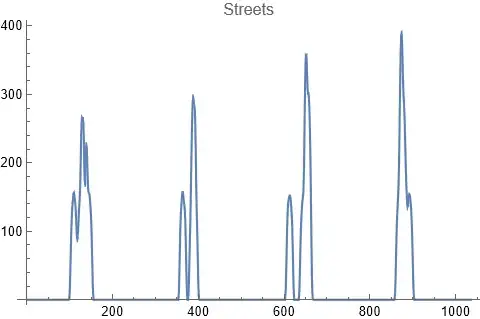

Smooth row and column sums to plot the marginal distributions of intensity.
"Streets" run left to right; "avenues" run straight up and down.
ListPlot[ListConvolve[{1,2,3,2,1}, (Plus @@ #)& /@ ImageData[j]], Joined->True, PlotRange-> {Full, Full},
PlotLabel->"Streets"]
Figure 6: Plot of "Streets"
You can post-process the locations of the peaks to identify the coordinates of the "street" centerlines. The values along the horizontal axis are pixels indexing the cropped image I have been using.

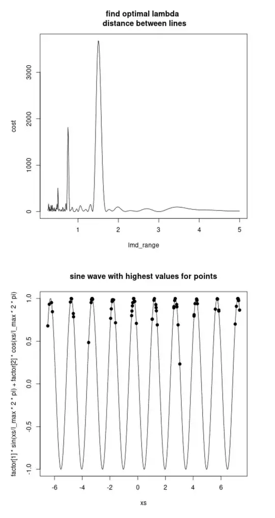

    In the code example below we fit a sine wave such that the following function is maximized $$\sum_{k=1}^n \sin\left(\text{offset}+2 \pi \frac{x_k}{\lambda} \right)$$ the advantage of the sine wave is that it allows simple algebraic computations to find the optimal $\lambda$ and $\text{offset}$.
    fitting grid on 1D line
    After reading the answer by Dan Piponi, I realize that this is effectively computing a Fourier transform.
  • Compute some cost function using the distances of the points to the vertical and horizontal grid lines (possibly the sine wave cost function of the previous paragraph could be used, but I imagine that using something else, like squared distance, might result in less variance of the error).
    In the example below we rescale and shift the points again such that we get grid lines at $x=0,1,2,\dots$ and we can use round off function to easily compute the distance.
    grid lines added on rescaled points
Then you repeat the above with different values of $\theta$ to find the optimum for that parameter
sweep with different theta
In the above graph there is a clear minimum at -5 degrees, which is how the data was generated.
One remaining problem is that for different angles there are also minima and these are due to the tendency of adding more grid lines than the true model (overfitting). You need some way to limit the total amount of grid lines. For this you need prior information.
The fit above is an improvement from the code below. It is using the scaling to add a penalty for adding too many grid lines (this will scale the image more strongly and increase the distances). Instead of computing the distance as

kx = rep(1:nx,each=ny) - (nx+1)/2+0.3 ky = rep(1:ny,times=nx) - (ny+1)/2 x = kxdx + rnorm(nxny,0,sigma_x) y = kydy + rnorm(nxny,0,sigma_y) rx = cos(theta)x-sin(theta)y ry = sin(theta)x+cos(theta)y sel = which(rbinom(nx*ny,1,p_sel) == 1) sx = rx[sel] sy = ry[sel]
plot(sx,sy, main = "original data")
example of rotated data
alpha = -62pi/360 tx = cos(alpha)sx-sin(alpha)sy ty = sin(alpha)sx+cos(alpha)sy plot(tx,ty, main = "rotated data")
function to find a regular grid for 1d data
fitting by maximizing a sine wave
we search for the offset of the wave and the wave length
fitpoints = function(s,lmd_range, plt = TRUE) {
initial search for wavelength
cost = sapply(lmd_range, function(z) sum(sin(s/z2pi))^2 + sum(cos(s/z2pi))^2 ) l_max = lmd_range[which.max(cost)]
if(plt) { plot(lmd_range, cost, type = "l", main = "find optimal lambda \n distance between lines") }
given optimal wave length
search for offset
this makes use of the linear sum of cosine and sine waves
sin(x+b) = cos(b)sin(x) + sin(b)cos(x)
ss = sum(sin(s/l_max2pi)) sc = sum(cos(s/l_max2pi))
M = matrix(c(ss,sc,sc,-ss),2,byrow=TRUE) factor = solve(M) %*% c(sqrt(ss^2+sc^2),0) xs = seq(min(s),max(s),0.01)
if(plt) {
plot(xs, factor[1] * sin(xs/l_max2pi) + factor[2] * cos(xs/l_max2pi), type="l", main = "sine wave with highest values for points")
points(s, factor[1] * sin(s/l_max2pi) + factor[2] * cos(s/l_max2pi), pch = 19) }
angle = Arg(complex(real=factor[1],imaginary=factor[2]))
offset = -angle/2/pi*l_max+0.25*l_max
### return result
return(list(l_max = l_max, offset = offset))
modx = fitpoints(tx,seq(0.25, 5, 0.01)) mody = fitpoints(ty,seq(0.25, 5, 0.01), plt = 0)
ttx = (tx-modx$offset)/modx$l_max tty = (ty-mody$offset)/mody$l_max
plot(ttx,tty, pch = 21, main = "rescaled and shifted data \n ready to get distance to lines by using roundoff function") for (i in -30:30) { lines(c(i,i),c(-100,100),lty=2) lines(c(-100,100),c(i,i),lty=2) }

We can turn the problem of finding the points in a noisy grid into the problem of finding the peaks of a smooth function, which can be much easier.
If your points are $p_i$, define the function $f$ of 2D vector $k$ by $f(k)=|\sum_{i=1}^n\exp(i k\cdot p_i)|$. For your example set of points you'll get the function whose "heat map" looks likeenter image description here
(You can think of this as the Fourier transform of the function defined by placing Dirac deltas at the points.)
There's a 3x3 grid of (bright white) local maxima in the middle with 0 at the centre that form a parallelogram. The vectors giving the midpoint of the right side and the top side give a pair of vectors, call them $g$ and $h$. In this case we have roughly $g=(0.039,0.006)$ and $h=(-0.005,0.039)$. These define the "reciprocal" lattice to the one you want. You can get the original lattice by taking the inverse of the matrix whose rows are $g$ and $h$ and scaling by $2\pi$.
Here's some Mathematica code that plots the original points along side the points in the new perfectly regular latticeenter image description here
This doesn't give you the 'phase' of the points so you'll have to slide the lattice around until it fits.
Both the problem of finding bright peaks and sliding around a fixed lattice to get a fit are easier than the original problem. So this may make things easier for you.
On the negative side: this method is robust up to a certain amount of noise/deformation and then it quickly falls apart so you need to start with your worst examples and see if this approach can handle them. For example, I chose not to use this method for finding grid-points in a lens calibration method because even though the image looked grid-like, there was no actual regular grid that fit over the entire image due to the lens distortion.
If it's ambiguous which peaks to use you can, of course, write code that tries more than one pair of vector candidates.
Update: I think you don't need to do any shifting yourself. We can use the phase of the sum of the exponentials to extract the shift. Again, here is some Mathematica code: enter image description here

As an adjustable approach, you could try
  1. Rotate all the points by a fixed angle (around the origin or centre of mass, whatever suits).
  2. Project the rotated points to the x-axis and y-axis. This is just the x-values and y-values of the rotated points.
  3. Use k-means or a method of clustering points on a 1d line. K-means lets you specify the number of clusters, which here will correspond to the number of parallel lines in the non-uniform grid.
  4. The centres of the clusters says where the grid lines should go.
  5. Rotate the grid lines backwards by the same angle to line them up with the original points.
With this approach you can explicitly set the number of grid lines in each direction. If searching for a solution, the parameters to adjust are reduced to a float, and two integers (the fixed angle, the number of vertical lines, and the number of horizontal lines).
Here is an example solution from some hasty code. I eyeballed the angle and number of lines each way.
Sample solution of a grid imposed on the sample points. Produced by the attached code.
import matplotlib.pyplot as plt
import numpy as np
from sklearn.cluster import KMeans
def fit_grid_to_points( points, angle: float, vertical_lines: int, horizontal_lines: int ): rotated_xs, rotated_ys = rotate_points(points, angle)
x_centres = find_centres(rotated_xs, vertical_lines)
y_centres = find_centres(rotated_ys, horizontal_lines)
# Rotate the centres back. Match up with the original alignment.
x_centre_points = np.hstack((x_centres, np.zeros_like(x_centres))).T
y_centre_points = np.hstack((np.zeros_like(y_centres), y_centres)).T
rotated_back_x_centres = rotate_points(x_centre_points, -angle)
rotated_back_y_centres = rotate_points(y_centre_points, -angle)
return rotated_back_x_centres, rotated_back_y_centres
def main(): pts = np.array( [ (104, 131), (240, 136), (580, 183), (88, 234), (396, 277), (199, 431), (367, 451), (534, 464), (29, 554), (171, 627), (342, 628), (493, 638), (10, 739), (144, 747), (138, 927), (472, 966), ] ).T
angle = -0.14  # radians
vertical_lines, horizontal_lines = 4, 6
res_xs, res_ys = fit_grid_to_points(pts, angle, vertical_lines, horizontal_lines)
display_found_grid(pts, res_xs, res_ys, angle, vertical_lines, horizontal_lines)
def find_centres(values, number_of_centres: int): kmeans = KMeans(n_clusters=number_of_centres) # Reshape because this needs a dummy dimension. kmeans.fit(values.reshape(-1, 1)) return np.array(kmeans.cluster_centers_)
def rotate_points(points, angle): """Rotate the points around the origin by angle radians. Modified from https://stackoverflow.com/questions/34372480/rotate-point-about-another-point-in-degrees-python """ xs, ys = points[0, :], points[1, :] rotated_xs = np.cos(angle) * xs - np.sin(angle) * ys rotated_ys = np.sin(angle) * xs + np.cos(angle) * ys return rotated_xs, rotated_ys
def display_found_grid(points, res_xs, res_ys, angle, vertical_lines, horizontal_lines): xs, ys = points[0, :], points[1, :] plt.scatter(xs, ys)
for x_centre in np.array(res_xs).T:
    plt.axline(x_centre, slope=1 / angle, color=&quot;black&quot;, alpha=0.6)
for y_centre in np.array(res_ys).T:
    plt.axline(y_centre, slope=-angle, color=&quot;black&quot;, alpha=0.6)
plt.title(
    f&quot;Fitting a non-uniform ({horizontal_lines}x{vertical_lines}) grid to points\n&quot;
    + f&quot;using a fixed angle of: {angle:0.3} (radians)&quot;
plt.show()
if name == "main": main()
The quality of the solution will depend on the clustering algorithm. Here I used kmeans as a quick fix. A more carefully chosen algorithm might be smarter about ensuring minimum distances between clusters which will guarantee the lines aren't pushed too close.

  • I tried to use k means as well but it becomes problematic with larger amounts of points and also you would need to know the number of clusters in advance. – Sextus Empiricus Jul 08 '22 at 18:06
  • Interesting. In what way does it become problematic with larger amounts of points? I agree that figuring out the number of clusters can be tricky, but I'm sure some of the automatic methods would give a good initial guess. Something like increasing the number of clusters one by one until two cluster centres are too close might be enough for a first pass. There is a chance the maximum number of gridlines could be known apriori from when the data was gathered. – spyr03 Jul 08 '22 at 18:13
  • when I used a 10 by 10 grid and fitted ten clusters, then I did not get 10 evenly spaced clusters. The algorithm placed 3 clusters around a single center and missed two centers. This might also be related to optimizing of the k-means clustering, I did not dive into it deeper, – Sextus Empiricus Jul 08 '22 at 18:17
  • Hmm, thats a disappointing result. I tried using MeanShift instead, and out of the box with no tuning it picks out a decent 5x4 grid, with the last gridline being inbetween two sets of points. Adjusting the parameter bandwidth for it varied between too many lines and not enough. A rough trial of bandwidth = values.size * 2 seems to do the job, finding the same 6x4 grid that is pictured above automatically. I'm sure there is a very suitable clustering algorithm that the buck can be passed to. – spyr03 Jul 08 '22 at 18:46
  • Results look great! Thanks! I timed your code and got 0.037 seconds for this example and 0.068 seconds for a 10x15 grid example; so I don't see significant scaling issues. My code does the same examples in 0.018 and 0.029 seconds, respectively. For my purpose, it is not likely the grid will be any larger than 12x16. My algorithm does not require the values of the number of rows and columns or the angle of the grid. I use a simple loop to segment because its 1-dimensional and I thought a clustering algorithm might be too costly. I would have to compare success rates to see if this works better. – Jakub Jul 08 '22 at 20:31
