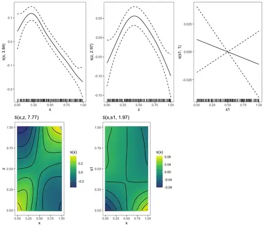

Q3: One of the main remaining questions (and most important question) that I have is how do I interpret these results given that x is in both? This answer https://stats.stackexchange.com/a/519601/32339 appears to suggest that if the same variable is in multiple interactions, I should decompose it as such:
m_2interaction_with_x2 <- gam(y ~ s(x) + s(z) + s(s1) + ti(x,z) + ti(x,s1), data=dat$data,  method="ML")
vizObj_m_2interaction_with_x2 <- getViz(m_2interaction_with_x2)
print(plot(vizObj_m_2interaction_with_x2, allTerms= TRUE), pages=1)
enter image description here But then how do I interpret the results? The relationship with just x or just z would be simple to interpret, but with linear models we generally don't want to interpret the main effects when there is an interaction. So should I interpret the s() at all here? And how do we interpret the plots showing the interactions with x and z or s1. Any tips for the best interpretation of the results would be fantastic!

You can solve your visulization problem if you keep the ti() versions in one of two ways:
  1. Create adjusted predictions from the model, varying the variables involved in the interaction you wish to visualize while keeping other variables at representative constant values (the observation closest to the median of each continuous variable, and the modal level for factor variables — you can get these from model$var.summary (replacing model with your fitted GAM)). This would yield data for a plot of the smooth on the response or link scale that includes the intercept and effects of any parametric terms, with the predicted values conditional upon the constants chosen for variables not involved with the interaction you are trying to visualise.
  2. Proceed as above but use predict(..., type = "terms") and compute the row sums of the columns of the returned object that relate to the smooths of interest (s(x), s(z), and ti(x,z)). This would give you an estimated surface that is similar to the one you plotted (with the smooth centred about 0) because in this formulation the intercept has not been included (nor would any parametric terms if you don't include those columns in the row sums.) You still have to provide a single constant value for each covariate that you aren't varying, otherwise predict() will throw an error.
In both of these you can also use the exclude argument to exclude the effects of named terms from the predictions - this isn't needed for option 2. as you are doing this manually when you only include selected columns in the row sums as that effectively excludes those terms related to the columns left out of the row sum.
When you get into more complex situations with covariates appearing in multiple smooths and random effects, you will need to use one of the above two approaches and likely you'll want the first, which allows you to have total control over what you are visualising as you are specifiying the values of the covariates that you want to predict at.
The data_slice() function in my {gratia} package can help with this (you'll need the development version which you can install from GitHub or my R-universe to have something that works well for the case you describe).
