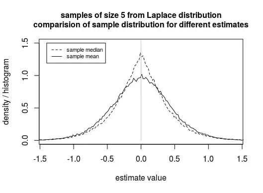

A similar question (if not the same) is: If the predicted value of machine learning method is E(y | x), why bother with different cost functions for y | x?
The theoretical mean of a distribution minimizes the squared error, but that does not mean that the sample mean is always the best estimator with regards the squared error loss function. The sample mean has a statistical variation.
In an answer to the above question an example is givem that shows how the sample median is performing better than the sample mean when the errors are Laplace distributed. Below is a copy of the image:
showcase that median can be better than mean
