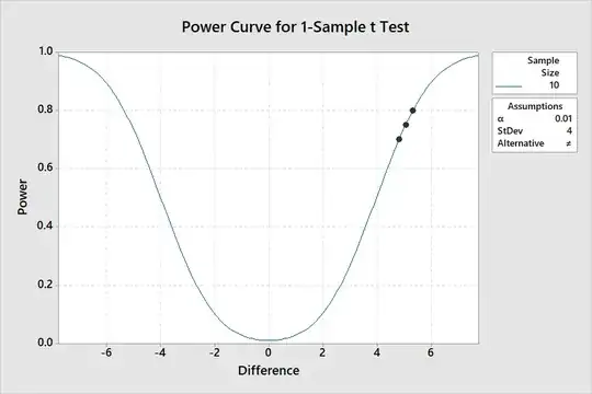

Possible situations abound. Here a few: Suppose you are testing $H_0: \mu = 50,$ against $H_a: \mu \ne 50$ at significance level $\alpha = 0.01 = 1\%,$ using $n = 10$ observations from a normal population with $\sigma \approx 4.$
Then a power and sample size procedure (here from a recent release of Minitab) gives power values about 70%, 75%, 80% for alternative values $\mu_a = 54.82, 55.06,$ and $55.33,$ respectively.
Power and Sample Size
1-Sample t Test
Testing mean = null (versus ≠ null) Calculating power for mean = null + difference α = 0.01 Assumed standard deviation = 4
Sample Size Power Difference 10 0.70 4.81897 10 0.75 5.05952 10 0.80 5.32813
Corresponding points on the relevant power curve are shown below:
Note: A trivial example is to set the Rejection region to be so far out into the tails of the null distribution (say, $|T|\ge 30)$ that $\alpha \approx 0.$ Then the power (probability of rejection for the specified alternative) could also be very small--in particular less than 80%.
