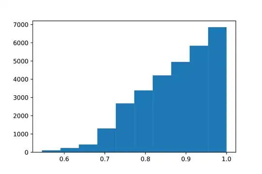

However when I do this in practice i.e. I plug a sample of $x$ values drawn from a sine distribution into the cosine, the resulting distribution of $y$ values is not uniform at all, but rather looks like this.

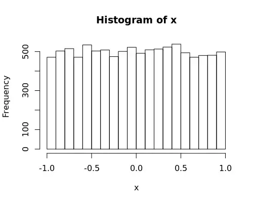

Running the resultant random numbers through the cosine tranformation yields:
x <- rep(0, 10000)
for (i in seq_along(x)) {
  x[i] <- cos(rsin())
hist(x)
which would seem to support your derivation!

The question doesn't require a specific programming language, which is fine, but I noted that the OP's plot looks like the default style of . @jbowman has given a useful implementation. Here is a similar implementation in case the OP would like to continue their project in .
First we can define a function rsin.
import numpy as np
def rsin(n): results = np.zeros(n) for i in range(n): while True: u = np.random.uniform(0, 2*np.pi) u2 = np.random.uniform() if u2 <= np.abs(np.sin(u)): results[i] = u break return results
And then we can plot the results using .
import matplotlib.pyplot as plt
plt.hist(np.cos(rsin(10000)), bins=20) plt.show()
Which produces the following plot:

There is no need for absolute values around your sine function. f(x) = sin(x) is a perfectly fine pdf on the sample space [0, pi/2]. As schotti points out, you can create an RV with this pdf by taking the inverse cosine (arccos) of a standard uniform RV; this follows from the Jacobian transformation that you have given in your question. That being the case, undoing the arccos by applying the cosine will obviously take you back to the standard uniform that you began with. Don't believe this? Here is an image of a pdf histogram (total area = 1) for a sample of 10^5 standard uniforms transformed by arccos, with the graph of sine superimposed. Clearly, this works.
