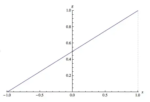

and let g(x) denote our Triangular(-1,1) pdf:
g = (1 + x)/2; domain[g] = {x, -1, 1};
PlotDensity[g]
Then, define the two-component mix pdf h(x):
h = (1 - α) f + α g  // FullSimplify
which returns output:
$(1 + x \alpha)/2$

Here is a plot of the two-component-mix pdf (using mathStatica/Mathematica):
PlotDensity[h /. α -> Range[-5, 5]/5]
