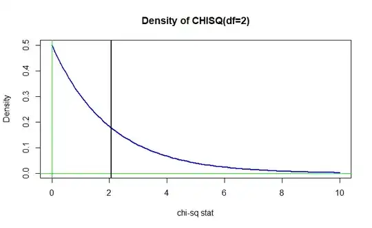

Maybe it will help to look at some data generated in a known way (using R). Suppose categories I, II, III occur in the proportion 1:2:4 before and after some event that one supposes might have changed the relationship between them.
set.seed(2022)
bef = sample(1:3, 2000, rep=T, p=c(1,2,4))
aft = sample(1:3, 3500, rep=T, p=c(1,2,4))
B = tabulate(bef);  B
[1]  284  586 1130
A = tabulate(aft);  A
[1]  535  973 1992
TAB = rbind(B,A); TAB [,1] [,2] [,3] B 284 586 1130 A 535 973 1992
The null hypothesis is homogeneity. That is, the proportions on rows A and B have essentially the same probabilities for the three categories.
If the agreement is good, the chi-squared statistic will be small, the P-value will be large, and we will not reject the null hypothesis.
Sometimes the chi-squared statistic is called a 'goodness-of-fit' statistic. That can be misleading. The better the fit the smaller the chi-squared statistic. (Maybe it should be called a 'badness-of-fit' statistic: the larger the statistic, the worse the fit.)
In R, here is Pearson's chi-squared test:
chisq.test(TAB)
    Pearson's Chi-squared test
data: TAB X-squared = 2.0562, df = 2, p-value = 0.3577
The expected counts are relatively near the observed counts in the matrix TAB.
chisq.test(TAB)$exp
      [,1]     [,2]     [,3]
B 297.8182 566.9091 1135.273
A 521.1818 992.0909 1986.727
Notice that expected count 297.82 is not far from observed count 284, and so on for the remaining five cells of the tables.
The first term of six making up the chi-squared statistic is $\frac{(284-297.8182)^2}{297.8182} = 0.6411383.$
Added together these six 'components of the statistic' sum to $2.0562.$
The degrees of freedom are $(r-1)(c-1) = (2-1)(3-1)=2,$ as noted in the output above. If the null hypothesis is true, we expect the chi-squared statistic to be near $2.$ Here, it is barely larger then $2.$
Below is a plot of the chi-squared density curve for 2 degrees of freedom, in which the vertical line shows the observed chi-squared statistic $2.0562.$ The area under the curve to the right of the vertical line is the P-value $0.3577.$ Because the P-value exceeds 5%, we do not reject the null hypothesis at the 5% level. That is, we have found no evidence that the two rows of TAB follow different probability models.
R code for figure:
curve(dchisq(x,2), 0, 10, lwd=2, col="blue",
  ylab="Density", xlab="chi-sq stat",
  main = "Density of CHISQ(df=2)")
 abline(v=0, col="green2")
 abline(h=0, col="green2")
 abline(v=2.0562, lwd=2)
