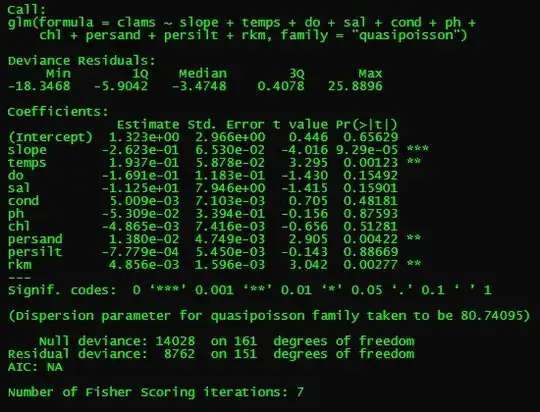

Background: I am modeling counts per square meter of an invasive species, which range from 0 to 380, as part of my master's thesis. The data set has 50 observed zeros out of 161 observations. After fitting a Poisson GLM with my ten explanatory variables, suspect results (all covariates having significant p-values of 2^-16) led me to the following series of actions:
  1. Suspecting overdispersion, a quasipoisson GLM was fit. The significance of certain covariates and their coefficients was congruent with published literature (yay! a signal!). Evidence for overdispersion was present, with theta = 80.74.quasipoisson GLM output
  2. For comparison, a negative binomial GLM was fit. The output was very similar to the quasipoisson, but several "glm.fit: algorithm did not converge" and an "alternation limit reached" warnings came with the output. I set the maximum number of iterations to 10,000 and ran it again- this time I got the convergence warning, but not the alternation limit being reached. No change in outputs with the different maxit values. negbin GLM output
  3. To compare the prediction of zeroes by my quasipoisson and negative binomial GLMs (and see if zero-inflation is an issue warranting evaluation of a zero-inflated GLM), I used the check_overdispersion() function in the "performance" R package on each to compare the number of predicted zeros to those observed in the response variable. The quasipoisson model only predicted 10% of the observed zeros (5 vs. 50), while the NB model predicted 98% of the observed zeros (49 vs. 50). A vif() check reveals no collinearity issues in either model, and calculation of Nagelkerke's r-squared using rsq() provides a value of ~0.32 for the negative binomial, while the "v" type r-squared for the quasipoisson model is about ~0.34.
My takeaway is as follows: It seems hard to justify using the quasipoisson model based on its underfitting of zeroes alone, while the negative binomial seems to be handling zeros with reasonable accuracy. Moving toward interpreting the NB model would have the twofold benefit of precluding the need for the somewhat-complicated zero-inflated GLM two-part model, while the baked-in provision of an AIC value for model selection purposes precludes the need for calculating QAIC if the quasipoisson were used.
