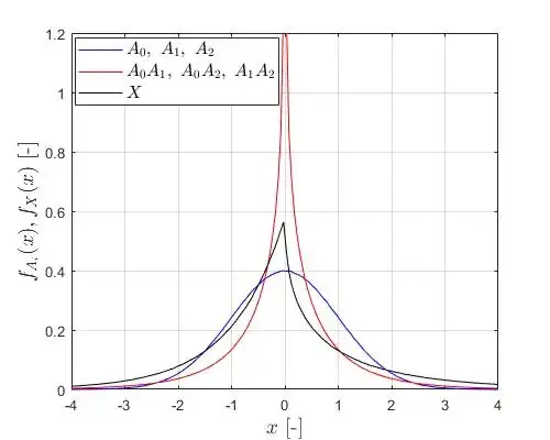

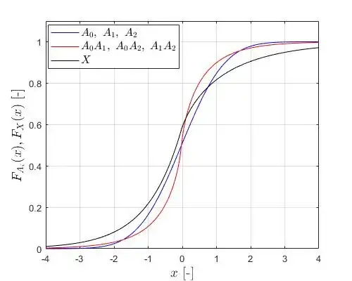

I have done some simulations in MATLAB and obtained the following graphs of PDF and CDF:
Basically, I am looking for a mathematical representation of the black curve in the above PDF graph. I cannot help myself but it seems very counter-intuitive that $X$ has a nonsymmetric PDF.

    This is a quadratic form and therefore can be diagonalized. Because it is not positive-definite, the result will be a difference of multiples of chi-squared distributions. You can compute it using characteristic functions (or mgfs), following the methods at https://stats.stackexchange.com/a/72486/919 (chi-squared distributions are Gamma). The solution is given at https://stats.stackexchange.com/questions/478495. – whuber Mar 10 '22 at 21:24
  • Re intuition about asymmetry: at first blush that is a surprise. But what would it take to negate $X$? You can't accomplish that with any of the obvious symmetries of the $A_i:$ permuting them won't alter $X$ and negating any subset of them does not negate $X.$ The symmetries of $X$ can be found by diagonalizing its associated symmetric matrix: the direction $(1,1,1)$ is special and otherwise the form is rotationally invariant around that axis, giving eigenspaces of dimensions $1$ and $2,$ resp. Thus the distribution of $X$ is the difference of chi-squared distributions with different df. – whuber Mar 10 '22 at 23:34
