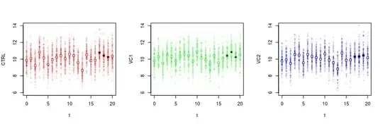

    Below is an example figure where data is randomly generated. For each time point and each group time point combination, a random mean is drawn from a random distribution.
    example
    Say you measure a hundred times in time points 17, 18, 19. If there is a significant difference and there was a decreasing trend then this doesn't mean that the parameter is a decreasing function of time. It means that those three temperatures in the three time points were different
    Because your small amount of data points (you have 14000 points but only 3 different times) you should not interpret the significant coefficient for time as an indication for a time trend. It means that the three time points were different (and this could have been random variation between time points instead of the outcome being some deterministic function of time). In order to determine whether there is a significant trend in time you need more time points.
So yes, you can reduce the sample an interpret your sample to be only 3 points (in time) instead of 14000.
And you should do it this way if you want to interpret the result (significance) as a significant time trend. The 3 different years are significantly different but the coefficient of a linear time trend is not significant if you only have 3 time points.
