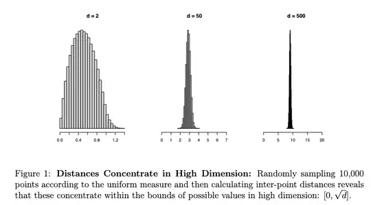

Yes, high dimensional space is tough in general, but there a couple things that make Bayesian optimization with Gaussian processes particularly perplexing on those prickly problems.
In my view, there isn't a single reason high dimension makes BO difficult, but the difficulty is rather due to a confluence of multiple factors.
Firstly, Bayesian optimization is classically conducted with a Gaussian process using something like a squared exponential kernel. This is a kernel which gives great flexibility which is perfect in low dimension but can become a liability in high dimension, as it puts reasonable probability mass on too many explanations of the point cloud. So the first issue is that the model we're using is already struggling to understand what's going on.
This is related to the volume argument from the other answer. Since GPs depend explicitly on distances, when all interpoint distances are equal and large, the GP has little discrimination power.
See how as we go into higher dimension, the distances between random points vary less than in low dimension:
high distances ["A survey on high-dimensional Gaussian process modeling with application to Bayesian optimization" by Mickaël Binois and Nathan Wycoff ]
