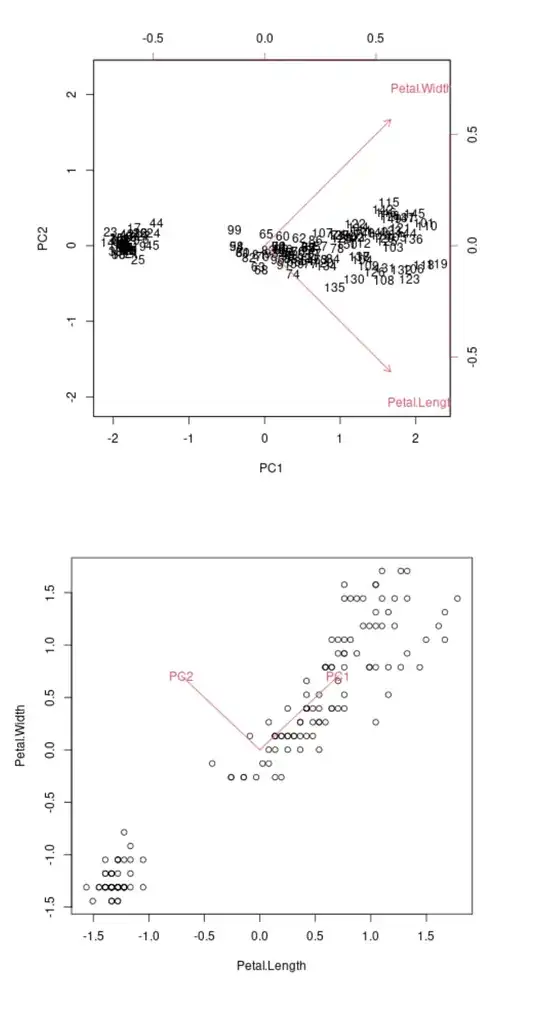

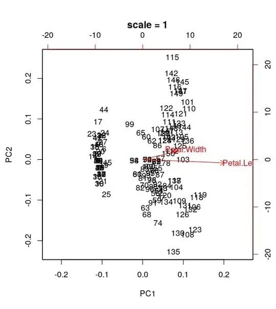

Because look at the following two PC biplots made in R on a subset of the iris data set (namely, iris[, 3:4]). Due to only two variables being used, the cosine of the angle between the two vectors should be exactly the correlation between the GH biplot. Note that in the case with scale = 0 the angle is 90 degrees and thus the cosine of the angle is 0, which clearly isn't correct.
A biplot where scale has been set to 0.
A biplot where scale has been set to 1.

The behaviour of scale=0 (no scaling) seems intuitive to me. The effect is just a rotation of the data but no change of the axis. The axes are perpendicular because they are only rotated and not scaled. Is a BH biplot with or without scaling?
The image below illustrates how the biplot without scaling is just a rotation of the 2D data. The upper plot is the plot with the PC as axes, the lower plot is with the petal width and length as axes.
The difference with scale = 1 is that you stretch the PC2 such that the cloud of data points is not such a flat shape on the y-axis.
example
Is the 'thing with the angles' maybe about the correlation between between the petal.width and petal.length and the PC components?
