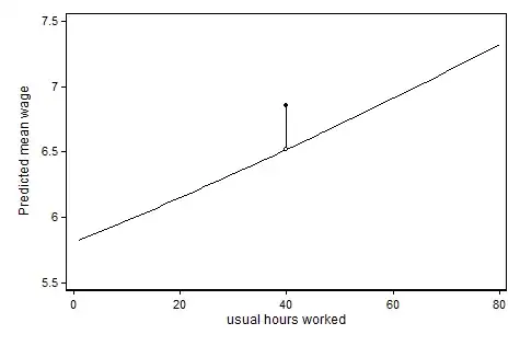

To expand a bit on the answer of @ken-butler. By adding both the continuous variable (hours) and an indicator variable for a special value (hours = 0, or non-breastfeeding), you think that there is a linear effect for the "non-special" value and a discrete jump in the predicted outcome at the special value. It helps (for me at least) to look at a graph. In the example below we model hourly wage as a function of hours per week that the respondents (all females) work, and we think that there is something special about "the standard" 40 hours per week:
The code that produced this graph (in Stata) can be found here: http://www.stata.com/statalist/archive/2013-03/msg00088.html
So in this case we have assigned the continuous variable a value 40 even though we wanted it to be treated differently from the other values. Similarly, you would give your weeks breastfeeding the value 0 even though you think it is qualitatively different from the other values. I interpret your comment below that you think that this is a problem. This is not the case and you do not need to add an interaction term. In fact, that interaction term will be dropped due to perfect collinearity if you tried. This is not a limitation, it just tells you that the interaction terms does not add any new information.

There is however something weird about $\beta_2$ though, as it measures the effect of breastfeeding by comparing the expected outcome of those who do not breastfeed with those that breastfeed but do so only 0 weeks... It kind of makes sense in a "compare like with like" sort of way, but the practical usefulness is not immediatly obvious. It may make more sense to compare the "non-breastfeeders" with those women that were breastfeeding 12 weeks (approx. 3 months). In that case you just give the "non-breastfeeders" the value 12 for $weeks\_breastfeeding$. So the value you assigning to $weeks\_breastfeeding$ for the "non-breastfeeders" does influence the regression coefficient $\beta_2$ in the sense that it determines with whom the "non-breastfeeders" are compared. Instead of a problem, this is actually something that can be quite useful.
