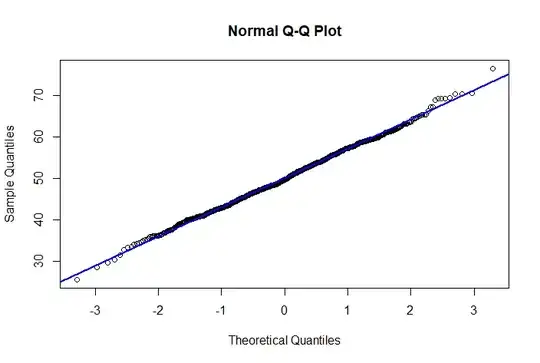

(5) Goodness of fit tests. If you suspect that data are normal and have a few thousand observations, you might try a Shapiro-Wilk GOF test to see if your suspicions have validity. In for the sample below (generated as normal), it is no surprise that that the S-W P-value is large, suggesting that the data are consistent with a normal distribution.
set.seed(2022)
x = rnorm(1000, 50, 7)
shapiro.test(x)
    Shapiro-Wilk normality test
data: x W = 0.99812, p-value = 0.3351
One might also use a normal probability plot (quantile-quantile plot), which should show points mostly along a straight line for truly normal data (not being too fussy about linearity near the right and left ends).
qqnorm(x);  qqline(x, col="blue", lwd=2)
