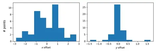

My data points (of course) do not perfectly fit the model, thus there are residuals in $x$ and $y$ (i. e. the measured coordinates have some offset from where they should lie according to the fit at the corresponding time):

    The parameters of a "3rd order polynomial" also include the rate of change of the acceleration. Are you truly fitting 3rd order polynomials, or are you just fitting 2nd order polynomials? As far as the substance of your question goes, it is natural to analyze the 2D distribution of the residuals. You can map them, for instance, and summarize them using bivariate statistics such as their first and second moments. A plot that connects 2D residuals according to their time sequence can be especially revealing. You can also use Complex numbers, as in https://stats.stackexchange.com/a/66268/919. – whuber Jan 31 '22 at 17:25
    Thanks @whuber, you're correct, I meant 2nd order (though in reality it actually depends; I also fit 3rd order polynomials). But I guess that shouldn't change the outcome. And thanks for the other information. I'll check it out! – mapf Jan 31 '22 at 17:51
