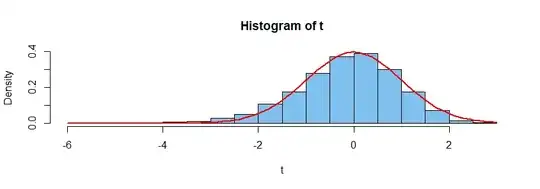

By contrast, samples of size $n = 50$ from a standard uniform distribution behave well.
set.seed(129)
m = 10^4;  n = 50
MAT = matrix(runif(m*n), nrow=m)
a = rowMeans(MAT);  s = apply(MAT,1,sd)
cor(a, s)
[1] -0.01452768   # nearly independent
$T$ statistics are nearly distributed as $\mathsf{T}(\nu=49).$ So one could trust results of a t test on such uniform data.
t = (a - 1/2)/(s/sqrt(50))
hist(t, prob=T, br=20, col="skyblue2")
 curve(dt(x,49), add=T, col="red")
