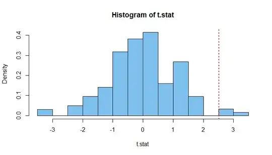

Without ties, there would potentially be ${9\choose 5} = 126$ different possible values of the t statistic. With ties, there are fewer, and 2.523 is one possible value. Also, it is clear the there is a larger value of the t statistic (from switching the 11 in group 1 with the 12 in group 2).
It would be moderately messy to use combinatorial methods to find the exact permutation distribution of the t statistic, arising from random assignments of the nine observed values to two groups of sizes 5 and 4, respectively. But we can get a good approximation to the permutation distribution by looking a t values resulting from 100,000 random rearrangements of the data into the two groups.
set.seed(2022)
t.stat = replicate(10^5, t.test(x~sample(g), var.eq=T)$stat)
mean(t.stat >= 2.52)
[1] 0.02379
round(table(round(t.stat, 3))/10^5, 3)
-3.085 -2.297 -1.752 -1.328 -0.973 -0.659 -0.369 -0.091 0.016 0.024 0.048 0.071 0.065 0.094 0.088 0.102
0.183 0.463 0.76 1.085 1.46 1.916 2.523 3.451 0.119 0.088 0.080 0.087 0.047 0.047 0.016 0.008
length(unique(t.stat)) [1] 16
So there are 16 unique values of the t statistic with approximate probabilities as shown above, and the approximate P-value of the permutation test is $0.024.$ A histogram of the approximate distribution of the t statistic under $H_0$ is shown below.
Under the null hypothesis, one assumes that any five of the nine observed values might have come from group 1. This is the basis of finding the permutation distribution of our metric (the t statistic) under the null hypothesis.
In this example, the null hypothesis is that the two populations are the same. So that assumption governs the distribution of whatever test statistic is used.
