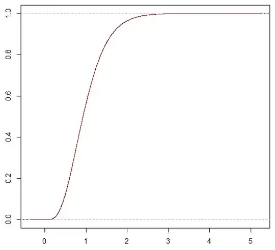

To illustrate that this particular case does have that distribution, here are the cdf and density from the simulation (black) compared to the theoretical curves (red). The overlap is so good that it is difficult to distinguish the curves
plot.ecdf(sims)
curve(pchisq(9*x, df=9), add=TRUE, col="red")
