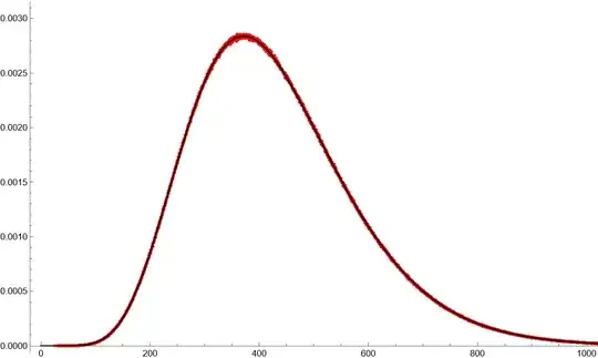

and variance is $$8 \left(2 \mu ^6 \sigma ^2+21 \mu ^4 \sigma ^4+48 \mu ^2 \sigma ^6+12 \sigma ^8\right)\tag{4}$$ Check by simulation
The histogram for 300 million samples with $\mu=4.5,\sigma=0.4$ agrees well with the theoretical PDF (black). The simulated (theoretical) values for the expectation are $429.591 (429.579)$ and for the variance $151.8317^2 (151.8326^2)$.
