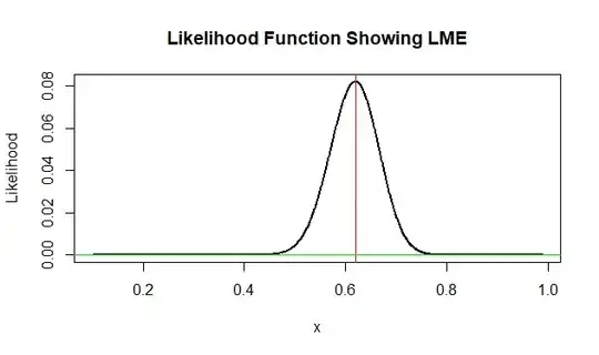

The maximum can be found by the usual methods of calculus. Below is a graph of a numerical solution, in which a 'grid search' is used to find p for which like is maximized. For $n=100, x = 62,$ the MLE is $\hat p = x/n = 0.62.$
p= seq(.1, .99, by = .001)
like = dbinom(62, 100, p)
mle = p[like==max(like)];  mle
[1] 0.62
The following plot illustrates the likelihood function and its maximum.
hdr = "Likelihood Function Showing LME"
plot(p, like, type="l", lwd=2,
  ylab="Likelihood", xlab="x", main=hdr)
 abline(v = mle, col="red")
 abline(h=0, col="green2")

  • How does this answer the question? – Sycorax Jan 10 '22 at 23:36
  • My answer shows point and interval estimates of parameter $p.$ Your Answer (+1) discusses the MME of $p.$ I have added a note to my answer to illustrate the MLE of $p.$ I do not discuss the more difficult task of using data to estimate $n.$ – BruceET Jan 11 '22 at 00:41
  • I agree that this answer provides a (thorough!) description of the MLE for binomial $p$, but it doesn't seem to describe what OP's code is doing, or answer either of their enumerated questions. – Sycorax Jan 12 '22 at 18:32
