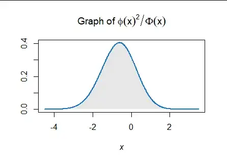

Figure
The problem, then, is to make this intuition rigorous. The rigor merely parallels the foregoing argument by making suitable quantitative comparisons.
When $x\gt 0,$ $\Phi(x)\ge 1/2$ (by a familiar symmetry argument). Whence (in this case) the integrand is bounded above in magnitude by
$$\bigg|\frac{\phi(x)^2}{\Phi(x)}\bigg| \le 2\phi(x)^2 \lt 2\exp(-x^2)/\sqrt{2\pi}$$
which (because it is proportional to the density of another Normal distribution) has a finite integral.
The harder part is the integral over negative $x.$ But here, the Mills Ratio is
$$R(-x) = \frac{\Phi(x)}{\phi(x)}$$
which, as the linked post explains, is bounded below by $-x/(x^2+1).$ Thus, for large negative $x$ (say, $x \le -1$),
$$\bigg|\frac{\phi(x)^2}{\Phi(x)}\bigg| = \bigg|\phi(x)\left(\frac{1}{R(-x)}\right)\bigg| \le \phi(x) \frac{x^2+1}{|x|} \le 2|x|\phi(x)$$
whose integral also converges (it can integrated exactly using elementary techniques). Figure 2
Since $\phi(x)^2/\Phi(x)$ is bounded on the remaining interval $[-1,0],$ we have established that its integral over the entire real line is bounded in magnitude by the sum of three convergent quantities, whence it is finite, QED.
