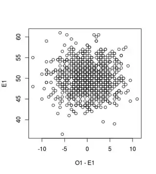

1) an example/illustration of this independence is made with the following image and R-code
independence
set.seed(1)
O1 = rbinom(n,100,0.5)
O2 = rbinom(n,100,0.5)
E1 = 0.5*(O1+O2)
plot(O1-E1, E1)
  • Thank you, that is helpful. I wonder if your two points are sufficient by themselves, or is my point also needed to show that "this is not a problem" (w.r.t. the OP's question). My intuition was that my point was of first-order importance, but perhaps it is not? In other words, if the variance of the distribution of the difference between the true and the estimated $E_i$ did not shrink with the sample size and stayed as large as with $n=1$, would this be a problem? – Richard Hardy Jan 10 '22 at 07:10
  • I see mainly 2 points of which the 2nd relates to yours, but it is only in the denominator where it counts. So we have 1 The influence of $E_i$ is very small in the numerator term $E_i-O_i$ because of the (approximate) independence. This is independence is not because $E_i$ approaches a constant (law of large numbers) but instead because the observations approach a multivariate normal distribution (where the parameters like $O_1 - O_2$ and $O_1+ O_2$ are independent). 2 There is some influence of the parameter $E_i$ in the denominator. In that place you get that your point plays a role – Sextus Empiricus Jan 10 '22 at 07:15
