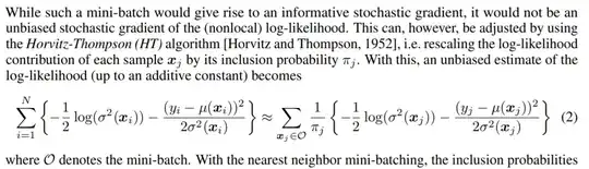

In this paper, the authors claim to be using a robust likelihood function:
Excerpt from paper
The code for this paper is on github and is referred to as t_likelihood. Isn't this just a log Gaussian likelihood? What's robust about this function?

  • I'm not claiming to understand the paper in its entirety, but IIUC, the authors use the term "robust" when describing how they use a Bayesian hierarchical model with an inverse gamma prior. They use the HT algorithm to "unbias" the mini-batch estimator which they claim has better convergence properties than a full estimate being sparser due to less data in the sample. – Avraham Dec 22 '21 at 13:59
    I've re-read the paper and also the online supplementary material and I think this is the closest answer. By "robust" they sample variance from an inverse Gamma distribution (in the paper, even though the code seems to be using a regular gamma distribution). – stevew Dec 23 '21 at 10:37
  • So I'll turn it into an answer 8-) – Avraham Dec 23 '21 at 14:06
I'm not claiming to understand the paper in its entirety, but if I understand it correctly, the authors use the term "robust" when describing how they use a Bayesian hierarchical model with an inverse gamma prior on the sigma parameter of the Gaussian distribution. The resulting predictive distribution is a Student-t which is the common substitute for the normal when the variance is unknown.
The authors use the HT algorithm to "unbias" the mini-batch estimator which they claim has better convergence properties than a full estimate being sparser due to having less data to crunch in each of the individual samples.

  • Thanks for your reply. Seems like they call it "robust" because they sample variance from an inverse Gamma distribution. – stevew Dec 23 '21 at 10:38
