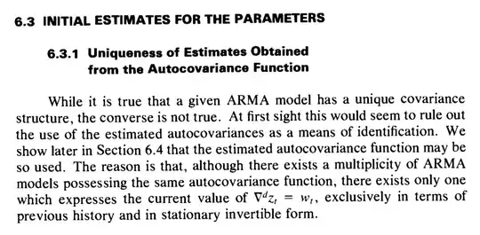

Again, in chapter 6, about model identification: img 3 And img 4
Earlier it is stated: “Identification methods are rough procedures applied to a set of data to indicate the kind of representational model worthy of further investigation. The specific aim here is to obtain some idea of the values of d, p, q ... and to obtain initial estimates for the parameters”.
So, to assure the identification procedure can logically be used to uniquely identify a model (why couldn’t more than one model be “identified” for further investigation?), they exclude non invertibile models, apparently making them “not worthy of further investigation”. To me this makes sense only if we assume normality. They seem to point that “expressing the current value $w_t$ exclusively in terms of previous history” is required for a model, (4) why would it be?
