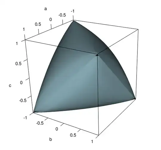

If the correlations between the three variables are $a$, $b$ and $c$, the eigenvalues of the correlation matrix satisfies $$ \left|\begin{matrix} 1-\lambda & a & c \\ a & 1-\lambda & b \\ c & b & 1-\lambda \end{matrix}\right|=0 $$ which after some algebra simplifies to $$ (1-\lambda)^3 - (1-\lambda)(a^2+b^2+c^2)+2abc=0. $$ For given values of $a$ and $b$, the correlation matrix is positive semi-definite when $c$ lies in a closed interval. At the endpoints of this interval, one of the eigenvalues are zero implying that $$ 1-a^2-b^2-c^2+2abc=0. $$ Solving this quadratic equation for $c$, we find that the endpoints of the interval of possible values of $c$ (plotted below) for given values of $a$ and $b$ are $$ ab\pm \sqrt{(a^2-1)(b^2-1)}. $$ If $a$ and $b$ are of opposite sign, the whole interval for $c$ thus contains only negative values if $$ ab+\sqrt{(a^2-1)(b^2-1)}<0. $$ Moving $ab$ to the right hands side and squaring both sides yields $$ (a^2-1)(b^2-1)<a^2b^2 $$ which simplifies to the condition $$ 1<a^2+b^2. \newcommand{corr}{\operatorname{corr}} $$ Thus, to summarise, if $a=\corr(X,Y)$ and $b=\corr(X,Z)$ are of opposite signs and $(a,b)$ lies outside the unit circle, then $c=\corr(Y,Z)$ is necessarily negative.
