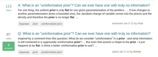

On this forum, there are a lot of related questions and answers about flat priors, like the ones above. They are not uniform priors because they are not distributions but $\sigma$-finite measures (with infinite mass) and they are not the most uninformative or non-informative priors for many reasons detailed in these answers (and Bayesian textbooks). If the posterior attached to the likelihood $f(x|\theta)$ and a flat (constant) prior $\pi(\theta)=c$ is well-defined, ie can be normalised into a probability density for almost all realisations of the random variable $X$ behind the observed data, $$\int_\Theta f(x|\theta)~\text d\theta < \infty\qquad\forall x\quad\text{a.s.}$$ then using this extension of the standard Bayesian framework is acceptable.
Note: the question is unrelated to MCMC (although one should not use MCMC with an improper posterior). The proper entry keyword is improper priors which is a section or a chapter of all Bayesian textbooks. Improper priors are $\sigma$-finite measures $\pi(\cdot)$ (with infinite mass) that can be used as prior measures provided $$\int_\Theta f(x|\theta) \pi(~\text d\theta) < \infty\qquad\forall x\quad\text{a.s.}$$ A flat prior (over an unbounded space) is a particular case of improper prior but not a very special one since a flat prior does not stay constant under most reparameterisations (changes of variables).

    Might be worth linking to https://stats.stackexchange.com/questions/20520/what-is-an-uninformative-prior-can-we-ever-have-one-with-truly-no-information which you illustrate at the top – Henry Dec 19 '21 at 13:08
