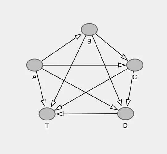

New corrected example
Let us consider
$A\sim N(0,1)$
$B\sim A + N(0,1)$
$C\sim A + B + N(0,1)$
$D\sim A + B + C + N(0,1)$
$T\sim A + B + C + D + N(0,1)$
The DAG associated to this experiment is the following
Let us study association between $C$ and $T$. The d-separation criteria tells us that in this BN, without conditioning on any variable all the paths from $C$ to $T$ are open and I expect that, by closing some of them, the dependency between $C$ and $T$ decreases. In this particular graph, we expect the dependence by conditioning on $\{A,D\}$ to be higher than the one obtained by conditioning on $\{A,B,D\}$ since the latter case blocks $T\leftarrow B \rightarrow C$ as well as the paths through $A$ and $D$. Putting this in formulas, we expect to see
$dep(C,T|\{A,D\}) > dep(C,T|\{A,B,D\})$
By using the negative p-value as a dependence measure (as suggested here) these assumptions are violated since the R code outputs
$dep(C,T|\{A,D\}) = -pvalue_{C\perp T|\{A,D\}} = -1.78*10^{-09}$
$dep(C,T|\{A,B,D\}) = -pvalue_{C\perp T|\{A,B,D\}}= -1.52*10^{-11}$
therefore
$dep(C,T|\{A,D\}) < dep(C,T|\{A,B,D\})$
Any idea why this happens? May that be that the p-values (and the negative p-values as well) are not suited for studying dependency comparisons as the one I did?

DaSim
  • 400
  • It's the backdoor criteria, not the d-separation criteria. And not all the paths are open. There are colliders in the graph, so some paths are already closed. You open one by adjusting for D, for example, but then close it later by adjusting for B.
    The article doesn't make clear what they mean by a negative p-value, so it's difficult to explain this, sorry :-(
    – mribeirodantas Dec 20 '21 at 16:19
  • For negative p-value they just mean to reverse the p-value sign – DaSim Dec 20 '21 at 16:33
