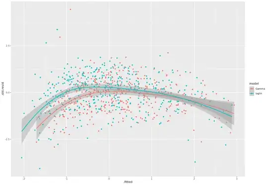

rr <- purrr::map_dfr(list(loglin = m2, Gamma = m3), augment, .id = "model")
ggplot(rr, aes(.fitted, .std.resid, colour = model)) +
    geom_point() + geom_smooth()
However, the same nonlinear patterns are still present in the residuals (maybe a little less pronounced for the Gamma fit).
diagnostic plot
Finally, adding a squared DBH term to the model (m4 <- update(m3, . ~ . + I(DBH^2)) appears to help a lot ...
