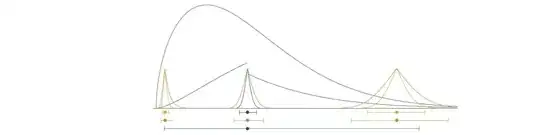

Below is a figure from my manuscript that works well to discern between confidence intervals, tolerance intervals, and prediction intervals in a non-normal setting. The large red density is the plug-in estimated sampling distribution, an estimate of the target population. The dark blue confidence curve and confidence interval show p-values and confidence intervals of all levels for inference on the population mean. The slightly wider orange prediction interval shows predictive inference on the sample mean for a future experiment. The yellow tolerance intervals show inference on the $2.5^{th}$ and $97.5^{th}$ population percentiles. The slightly wider orange prediction intervals show predictive inference on the sample percentiles for a future experiment. The green $95\%$ prediction interval shows predictive inference on a single subject sampled from the target population.
