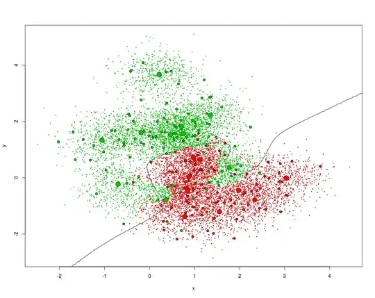

  • And there are even more possibilities when you have non-linear patterns like the next example
    results of the 9 nearest neighbours classification In this figure you see a nearest neighbours classification at work. The boundary is not a simple linear combination and many different patterns become possible.
