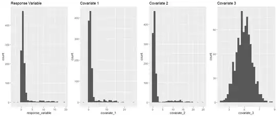

To illustrate my question, I created an example in which the covariates and response contain many zeros (using the R programming language):
#create non-zero data
response_variable = rnorm(100,9,5)
covariate_1 = rnorm(100,10, 5)
covariate_2= rnorm(100,11, 5)
data_1 = data.frame(response_variable, covariate_1, covariate_2)
#create zero data response_variable = abs(rnorm(1000,0.1,1)) covariate_1 = abs(rnorm(1000,0.1, 1)) covariate_2= abs(rnorm(1000,0.1, 1))
data_2 = data.frame(response_variable, covariate_1, covariate_2)
#combine both together final_data = rbind(data_1, data_2)
#add one regular variable
final_data$covariate_3 = rnorm(1100, 5,1)

My Question: (Although the above examples are probably unrealistic and a naive attempt to re-create real world problems) At first glance, none of the above regression models for "high density zero data" seem to outright "disallow" the covariates from containing many zeros - but are there any theoretical (or "logical") restrictions suggesting that the above models are unlikely to perform well on data where the covariates contain many zeros? In practice, can such regression models successfully model data in which the response variable and the covariates both contain many zeros??

Regression analysis accommodates situations where the explanatory variables/covariates can have any values, including zero. There is no particular model needed for this --- it can be implemented in almost any model. If there are lots of zeros for a particular covariate, the only issue this creates is that it affects the leverage of the data points and one must therefore be careful to assess the functional form of the posited relationship with the response variable.
