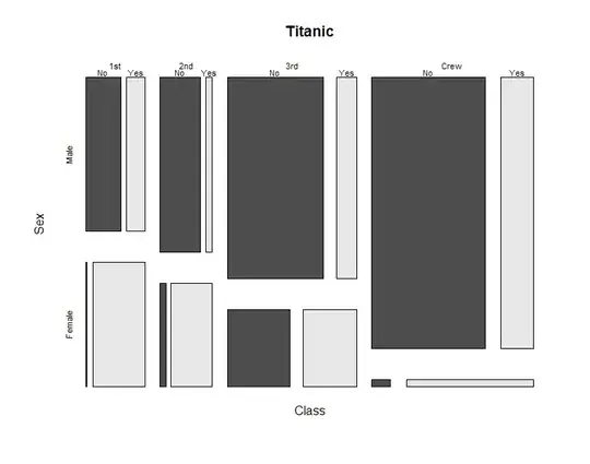

Recently I stumbled across a line graph displaying a contingency table which I found was a very powerfull visualization. In my opinion it is very seldom that nominal data is displayed this way; usually plots like a bar plot, mosaic plot etc. are used (see here or here for example).
To illustrate I provide a) a bar plot, b) a mosaic plot and c) a line plot for the same data. The Titanic data shows the frequencies for the variables Survived (yes vs. no), Sex (males vs. females) and class (1st, 2nd, 3rd and crew). I only included adults in the plots.

b) Mosaic plot
Mosaic plot
c) Line plot
Line plot
The line graph seems to clearly display what is going on, e.g. more males than females in total, class has a big effect on survival and so does sex, etc. Drawbacks of the line graph I can think of:

    Note that class is not nominal, but ordinal - there is a clear ordered relationship among classes. This makes the line graph a bit more appropriate, since you expect to see trends when moving from group to group. With nominal data, one should generally not expect to see across-group trends, since the ordering of groups is entirely arbitrary. – Nuclear Hoagie Nov 23 '21 at 14:10
  • @NuclearHoagie That is a great point! I`ll try to find a better example (or notice that without any order a line graph is not more informative, which would partly answer my question). –  Nov 23 '21 at 14:18

Answered in comments by @NuclearHoagie
