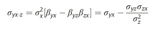

I'm reading Linear Models: A Useful “Microscope” for Causal Analysis. In the article, when discussing the beta coefficient and standard error of partial correlation, the auther mentioned "express βyx.z and σyx.z in terms of pair-wise relationships", which gives the following results.
enter image description here and enter image description here
In the article, the auther didn't specify details about the derivtion process. I've look for the answer in the textbook of Mathematical Statistics and online resources. But I couldn't find detail on the derivation process. Could anyone provide some direction, thanks!

Here $\varepsilon_{1.3}$ is the part of $y$ eliminating the linear effect of $z$, and $\varepsilon_{2.3}$ is the part of $x$ eliminating the linear effect of $z$. Then $\sigma_{yx.z}=\sigma_{12.3}$ is the partial covariance between $y$ and $x$ eliminating the effect of $z$, defined as
$$\sigma_{12.3}=\operatorname{Cov}(\varepsilon_{1.3},\varepsilon_{2.3})$$
Using normal equations, it is not difficult to show from this definition that
$$\boxed{\sigma_{12.3}=-\frac{\Sigma_{12}}{\sigma_3^2}} \tag{3}$$
This gives the formula
$$\sigma_{12.3}=\sigma_{21}-\frac{\sigma_{31}\sigma_{23}}{\sigma_3^2} \tag{3.a}$$
Again, from $$\beta_{12.3}=\frac{\operatorname{Cov}(\varepsilon_{1.3},\varepsilon_{2.3})}{\operatorname{Var}(\varepsilon_{2.3})}=\frac{\sigma_{12.3}}{\sigma^2_{2.3}}\,,$$
we have
$$\sigma_{12.3}=\beta_{12.3}\cdot\sigma^2_{2.3} \tag{4}$$
It can be shown that
$$\boxed{\sigma^2_{2.3}=\frac{\Sigma_{11}}{\sigma_3^2}}$$
Equivalently,
$$\sigma^2_{2.3}=\frac{\sigma_2^2\sigma_3^2 R_{11}}{\sigma_3^2}=\sigma_2^2(1-\rho^2_{23})=\sigma_2^2\left(1-\beta_{32}^2\cdot\frac{\sigma_2^2}{\sigma_3^2}\right) \tag{4.a}$$
Combining $(4.\text a)$ with $(4)$ and $(2.\text b)$ yields
$$\sigma_{12.3}=\sigma_2^2\left(\beta_{12}-\beta_{13}\beta_{32}\right) \tag{4.b}$$
