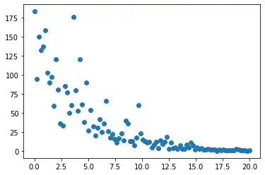

  • simulate data
sd = 0.5
m,b = -0.25, 5
X = np.linspace(0,20,100)
Y = np.exp(np.random.normal(loc=m*X+b, scale=sd))
plt.scatter(X,Y)
Sim data

My actual question: Using parameter estimates and confidence intervals, how might a Frequentist construct a similar revenue function plot? I understand that they could simply use the point estimates of the slope and intercept and then find a point estimate of the optimal price, but I'm curious about the variance around the optimal value.
For the code that simulated this data, generated this plot, and Bayesian model that inferred the posterior distribution, see here
