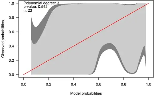

Calibration
For completeness sake, here are two other ways to produce calibration plots: The first is using calibration belts, introduced by Nattino et al. (2014)$^{1}$, Nattino et al. (2016)$^{2}$ and Nattino et al. (2017)$^{3}$. Briefly, they fit an $m$-th-order polynomial logistic function (with $m\geq 2$) to the observed outcomes using the predicted probabilities of the model to be assessed. The parameter $m$ is selected using a standard forward selection procedure controlled by a likelihood-ratio statistic that accounts for the forward process used to select $m$. The calibration belt can be used for internal and external calibration. The procedure is implemented in Stata (calibrationbelt) and R (package givitiR). Here is the example using the Challenger data:
# Challenger Shuttle Challenger temp vs oring-ok
dat <- data.frame(y=c(0, 0, 0, 0, 1, 1, 1, 1, 1, 1, 0, 1,
                       0, 1, 1, 1, 1, 0, 1, 1, 1, 1, 1),
                   x=c(53, 57, 58, 63, 66, 67, 67, 67, 68, 69, 70, 70,
                       70, 70, 72, 73, 75, 75, 76, 76, 78, 79, 81))
fit <- glm(y ~ x, data=dat, family=binomial)
preds_p <- predict(fit, type = "response")
cb <- givitiCalibrationBelt(o = dat$y, e = preds_p , devel = "internal", confLevels = c(0.95, 0.8))
plot(cb, main = "", las = 1, ylab = "Observed probabilities", xlab = "Model probabilities", table = FALSE)
CalibrationBelt
The identity line is displayed in red. The light gray area is the 80% confidence calibration interval whereas the dark gray is a 95% confidence interval. Ideally, the red line is inside the belt over the whole range of probabilities. In the example, the confidence intervals are huge: The calibration belt shows a large uncertainty with respect to calibration. As the red line lies within the interval, we cannot reject the hypothesis of a well calibrated model.

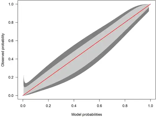

To better illustrate the calibration belt, let's look at a calibration belt of a well calibrated model:
CalibrationBelt2
Here, the confidence intervals are much narrower. Because the red identity line lies within the belt over the whole range, it offers little evidence for miscalibration.
