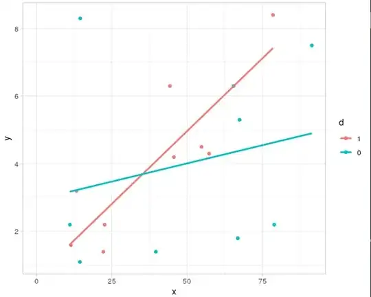

  • (Intercept) is the value of y when x == 0 and d == 1
  • x is the change in y for 1 unit change in x when d == 1 (i.e. the slope of the regression line). The slope is different from 0 at the significance level 0.0268 (compared to 0.002 when regressing using only the data at d == 1).
  • d0 is the change in intercept of the regression line between d == 1 and d == 0. I.e. the regression line when d == 0 has intercept 0.66304 + 2.27474
  • x:d0 Is the difference in slopes between the regression line with d == 1 and d == 0 (effect of interaction between x and d). I.e. the regression line when d == 0 has slope 0.08609 - 0.06460
You can visualize this with:
ggplot(data= dat, aes(x, y, colour= d)) +
    geom_point() +
    geom_smooth(se= FALSE, method= 'lm') +
    xlim(c(0, NA)) +
    theme_light()
