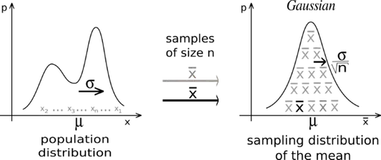

3) The distribution of these means will follow a normal distribution (this result is particularly useful for inferences, e.g. hypothesis testing and confidence intervals).
Illustration of central limit theorem leading to Gaussian distribution of sample mean

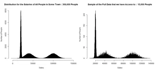

###plot
par(mfrow=c(1, 2)) hist(my_data$salary, 1000, ylab = "Number of People", xlab = " Salary ", main="Distribution for the Salaries of All People in Some Town: 300,000 People") hist(our_sample$salary, 1000, ylab = "Number of People", xlab = " Salary ", main="Sample of the Full Data that we have Access to: 15,000 People")
Enter image description here
Suppose we have access to the salaries of 5% of the people in this town (let's assume these are randomly chosen):

As we can see, the original data was clearly non-normal, but the distribution for the mean of random samples from this non-normal data appears to look "somewhat normal":
par(mfrow=c(1, 3))
hist(my_data$salary, breaks = 10000, main = "full data")
hist(our_sample$salary, breaks = 10000, main = "sample of the full data that we have access too")
hist(results_df$sample_mean, breaks = 500, main = "resampled data by bootstrap from the data we hace access to")
