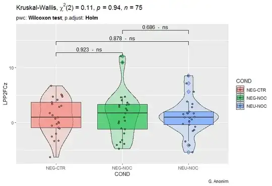

I would like to ask about the handling of outliers. I have a value table with different variables that come from three different trials. I wanted to use ANOVA followed by a t-test to compare the results obtained in each of the three trials. Unfortunately, for some tests, I identify one to several outliers. Below is an example diagram where outliers are marked with larger points.

Now a little more about my data. The data is from some medical experiment. I do not know the details. I only have data. Each patient underwent three tests (NEG-CRT, NEG-NOC and NEU-NOC). In each trial, some medical devices took 25 measurements of several different measurement signals. The data shown in the above graphs is data for a signal called LPP2FCz. The most important question I have to answer is whether the responses for these three trials are statistically significantly different.
One-way ANOVA + t-test seemed to be a good approach here. Unfortunately, in about 30% of the results, I cannot confirm that the data comes from a normal distribution (tested with the Shapiro-Wilk test). In addition, outliers appear in some cases. For this, my first step was to move towards non-parametric tests.
However, when analyzing the obtained results (regardless of whether it is ANOVA or Kruskal-Wallis), it is difficult to talk about statistically significant differences. Although, as @Michael Lew rightly pointed out, in the case of the NEU-NOC trial, we have the most outliers. However, can this be the basis for the inference that the results of this sample differ from the previous two trials?
Answering the question @Sal Mangiafico, the outliers were automatically determined by the geom_boxplot function from R. And as far as I know, they are calculated as values that are outside the range (quantile(x, .25)-1.5*IQR(x), quantile(x, .75)+1.5*IQR(x)). As for the Capping procedure, all lower outliers have been converted to quantile(x, .05) and upper outliers have been converted to quantile(x, .95).

    To some extent, I would expect this to depend on the context. Why are there outliers? Do you have a good reason to remove them, such as known bad data? Or are you pretty sure the outliers are real? – Adrian Keister Oct 22 '21 at 19:37
  • Welcome to CV. Thank you for the clear illustrations! – whuber Oct 22 '21 at 19:52
  • Outliers are real. I'm sure of that. – Marek Fiołka Oct 22 '21 at 19:58
  • If the outliers are 'real' in the sense of being accurate data points then leave them be. If your intended statistical inference concerns the populations from which your model assumes that data are sampled then you might prefer a non-parametric test. – Michael Lew Oct 22 '21 at 20:53
  • Sometimes the outliers represent interesting information. Is there any reason to suppose that NEG-CTR condition suppresses outliers? – Michael Lew Oct 22 '21 at 20:55
    One alternative you don't mention (but which would probably be my first thought) would be considering a distributional model that would be more suitable than just using ANOVA, with its assumed normality. Does your real hypothesis relate to means? What's your original response variable measuring? – Glen_b Oct 23 '21 at 03:35
  • I'm honestly perplexed by this example. 1) What criteria were you using to identify the outlying data in the first place ? For example, to me, it doesn't look like there are points outside, say 3 * IRQ. 2) What is the capping procedure used ? For example, if I'm reading the plots correctly, for Green, you had 2 points > 5, and then after you had 5 points > 5 ? Somehow the median of Blue dropped from about 2 to about 0 ? – Sal Mangiafico Oct 23 '21 at 16:50
    I guess I should also say too, that, for me, I would probably be comfortable conducting a traditional anova on the original data. The data don't seem too heteroscedastic or too not-conditionally-normal to me. I don't think the outlying observations would bother me too much, although I might go back and double-check the data for them. – Sal Mangiafico Oct 23 '21 at 16:56
  • For anyone interested. I added a small update to my question. – Marek Fiołka Oct 23 '21 at 19:37
    Using a non-parametric tests is fine but note that: i) formally testing the normality assumption is dubious and generally discouraged (see here) and ii) the hypotheses tested by the Kruskal-Wallis test are not the same as the hypotheses tested in an ANOVA. The test should be tailored to your research question and not be determined based on the data. Finally, using Wilcoxon-tests as pairwise tests after Kruskal-Wallis is not a sound procedure (use Dunn's test instead). – COOLSerdash Oct 23 '21 at 19:47
  • After reading your update I have formed the opinion that you are not in a position to usefully form any statistical inference based on these data. You need to know more about the nature of the measurements and their biological meanings. I suggest that you should discuss the issues with the experimenters in order that their scientific inferences might not be misdirected by ill-formed statistical inferences. – Michael Lew Oct 23 '21 at 20:34
  • @MarekFiołka , as far as I can see, if I'm understanding correctly, something is wrong with your capping algorithm. For your Green group, I don't see how it could start with 2 points > 5 and resulting in 5 points > 5. It should have moved those two high points to c. 9.6 ? And the median for the Blue group (if that's what shown in the plot) shouldn't have moved, I think at all. Am I misunderstanding something? – Sal Mangiafico Oct 24 '21 at 00:22
Generally outliers should only be removed if there is some clear suspicion (with reasons) that they are actually wrong. The outliers don't seem particularly harmful to me here. Kruskal-Wallis makes some sense and the p-value is about the same as from the t-test, so the overall message is pretty clear that there's no evidence that there are differences.
As there are several ways to deal with outliers, one can try out many things and at some point one may find something that gives a significant p-value, but note that p-values are generally invalid if they rely on some data dependent selection of results. There's no basis by the way as far as I'm aware for manipulating the outliers by capping, imputation, or "prediction" before running a t-test, so I'd leave my hands off these. The thing is, if the outliers are incorrect observations, they should be removed, and if they're correct, you're not going to improve your analysis by replacing them with something else that in fact is incorrect (which follows directly from the outliers being correct).
Not sure whether you mean by "better" in "I did Capping and it's much better now" that a significant result is better. That'd be dangerous because it means that you may tend to keep on analysing until you find significance, which is then a result of wishful thinking. The fewer tests you run, the more appropriate they will be (I wouldn't quite go as far as saying that not running any test is the most appropriate thing, but some would...). If the data don't show evidence that there are differences, you shouldn't try to wrestle a low p-value out of them.
