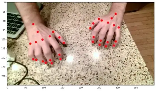

I started off with a dataset that has images like this: enter image description here

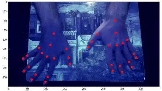

each annotated to have the red dots correlate to each keypoint. To expand the dataset to try to get a more robust model, I took photos of the hands with various backgrounds, angles, positions, poses, lighting conditions, reflectivity, etc, as exemplified by these further images: enter image description hereenter image description here enter image description here enter image description here enter image description here enter image description here

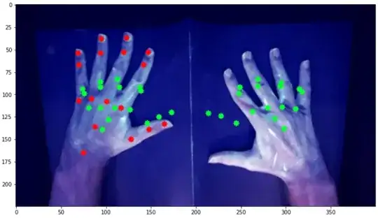

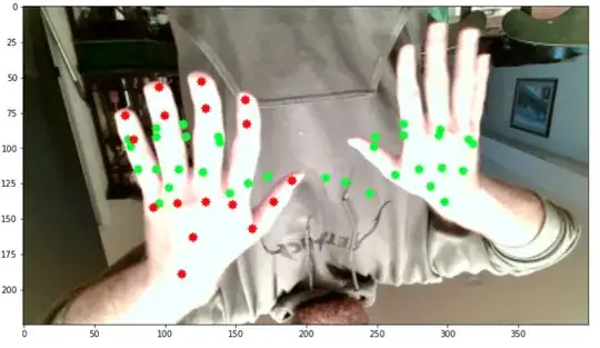

Furthermore, when I run predictions based off the model it seems that the predicted output is basically the same for every image, with only slight variation between each. It seems the model predicts an array of coordinates that looks somewhat like what a splayed hand might, in the general areas hands might be most likely to be found. A catch-all solution to minimize deviation as opposed to a custom solution for each image. These images illustrate this, with the green being predicted points, and the red being the actual points for the left hand: enter image description here enter image description here enter image description here enter image description here
